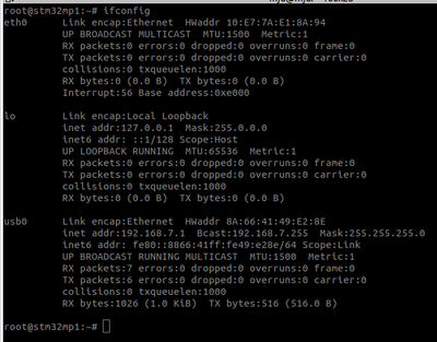

For my core-image-minimal build, after I run:
modprobe g_ether
ifconfig usb0 192.168.7.1 netmask 255.255.255.0the output of ifconfig looks just fine:
Any suggestions?
Best regards!
