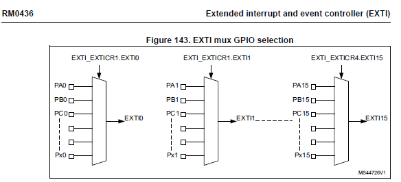

2022-12-21 1:59 AM
Please note that there is a inherent HW limitation in EXTI (common to most STM32 products) that there is only 16 GPIO interrupts and only one interrupt EXTIx could be set for all port with same index Py[x].See also https://wiki.st.com/stm32mpu/wiki/EXTI_internal_peripheral
You should align your overall GPIO EXTI interrupt choices to this HW constraint.

2022-12-21 1:59 AM
