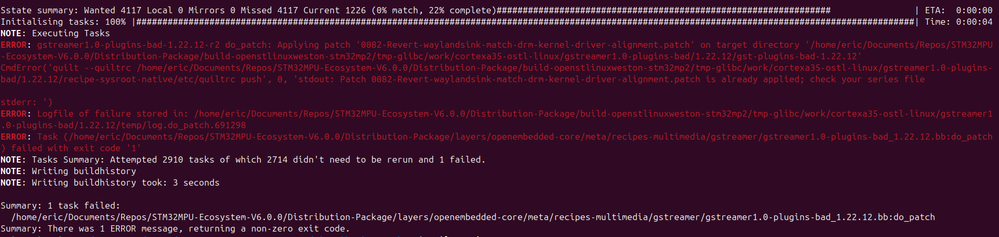

I am trying to get the X-LINUX-ISP expansion installed onto a MP257-DK board. I can not connect the board to a network at this time, so I have resorted to trying to build a distribution following the instructions here.
When I run bitbake, patches start to be applied and one of them fails, as shown here:
patch already applied
I am not familiar with build system being used here and have been unable to figure out where it is being given a list of patches to apply so that I can try and prevent the patch from being applied multiple times. I did attempt renaming the patch file to try and keep it from being found and applied, but that did nothing. I have been unable to find any series file that the Quilt command may be using.
If anyone could please point me in the right direction on what I need to do to avoid this error, that would be appreciated.

2025-03-27 7:43 AM
I could reproduce the same issue and the root cause comes from the ISP meta layer not updated for the latest OpenSTLinux release (v6.0.2).
New version of X-LINUX-ISP expansion layer will be pushed on github to be aligned with v6.0.2 (probably next week).
Meanwhile please take previous version:
https://wiki.st.com/stm32mpu/wiki/STM32_MPU_OpenSTLinux_release_note_-_v6.0.0#v6-0-1
For your Flash question, when you select your machine in Yocto distribution, It will generate all the config files (.tsv) to flash all the different memory of the selected board. So after build, you just need to select the right .tsv file corresponding to the memory you want to flash on your board.
2025-03-28 6:51 AM
you can also keep your OpenSTLinux v6.0.2 and update ISP layer like below:
PC> rm meta-st-x-linux-isp/recipes-multimedia/gstreamer/gstreamer1.0-plugins-bad_%.bbappend
This is just a workaround before new ISP layer is available.
