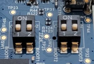

Note: UART/USB boot need BOOT pins in correct position as listed in the wiki:
