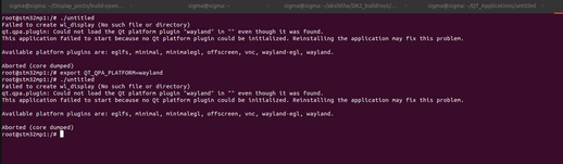

1.I have changed the distribution to weston and built st-example-image-qtwayland and implemented the same QT application executable file but it gives me the error mentioned in the attached screenshot.

2024-08-01 8:01 AM
@Srikanth1 ,
Please try to launch your Qt application with a such script :
# !/bin/sh
export QSG_INFO=1
export QML2_IMPORT_PATH=~/imports/
export PATH=/usr/local/qt5-install/bin/:/usr/local/apitrace/bin:$PATH
export QT_QPA_PLATFORM=wayland
#Execute the Qt program
export XDG_RUNTIME_SESSION=wayland; export XDG_RUNTIME_DIR=/run/user/`id -u weston`; export WAYLAND_DISPLAY=wayland-1; cd <PATH_APPLICATION> && ./<APPLICATION>
Replace <PATH_APPLICATION> and <APPLICATION> by your own information.
Kind regards,
Erwan.

2024-08-20 5:45 AM
@Srikanth1Have you tried and solved it ? I am having the same problem but can't solve it
