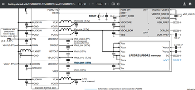

Also, if your board still fails at the end of SP_min then I may have an idea why.
You are using LPDDR2 and in that case LDO3 should be in bypass mode (if used as intended by ST) and not in sink-source mode (this is for standard DDR). LPDDR not use VTT voltage at all.
