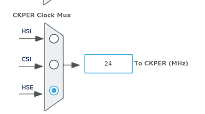

I never heard about the PER clock. I'm looking inside CubeMX, but I don't see any PER clock at all. I guess it's periferial clock. So how do I start it?
My U-boot won't boot. I guess that if PER will be like 24 MHz, then U-boot will continue. Or am I wrong?

2024-08-13 9:42 AM - edited 2024-08-13 4:11 PM
Hi! It seems that I have the same clock configuration. So this means it must be a bug?
Here is my device tree for Op-tee. Do you see something suspect? ;)

After fix:
By the way! CubeMX will clean the whole U-boot-mx.dts file in the device tree when I'm generating new code. It's two bugs counted now! Try it your self. Create and STM32MP151AAC3 project and write something within BEGIN and END commands of the U-boot-mx.dts file inside the DeviceTree folder. Then generate. See if it's disappear.

- PER : 24 MHz

2024-08-13 2:34 AM
Hello @DMårt ,
Yes this is peripheral clock, you can find related information in the Reference Manual (RCC chapter).
For the CubeMX configuration, you say that the PER clock is not inside, I am a bit surprised. Can you please double check, I can see this on my side (taken with the STM32MP157F-DK2 example project) :
Kind regards,
Erwan.
2024-08-13 3:43 AM
Oh, it's called CKPER clock. Intill check. I very sure it exists for MP151.
It might be the issue, i guess.
I will reply later.

- MCU : 208.878 MHz
- AXI : 266.500 MHz
D/TC:? 0 tee_ta_init_session_with_context:549 Re-open TA a8cfe406-d4f5-4a2e-9f8d-a25dc754c099
D/TC:? 0 tee_ta_close_session:451 csess 0xde050270 id 1
D/TC:? 0 tee_ta_close_session:470 Destroy session
- PER : 24 MHz
- DDR : 533 MHz
