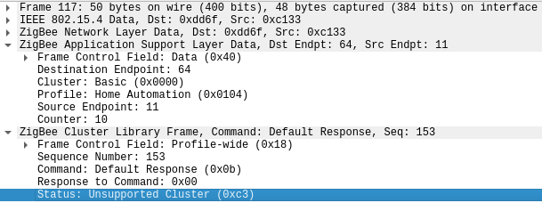

I am working with the STM32WB55 Nucleo board to create a Zigbee device being able to connect to a Philips Hue Bridge v2.1. Using a 2.4GHz sniffer with wireshark I am able to follow the communication which goes through the following steps with no problems:
Where it fails is the coordinator (hue bridge) sends a Read attributes on the Basic cluster (0x0000) to the STM32. It responds with a ZCL Default response where status says "unsupported cluster (0xc3)".

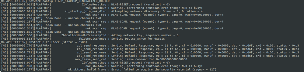

And the trace output from the STM32WB55 reports that it sends this default response, but I would expect it to be responding with the Basic attributes configured.
