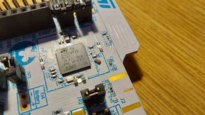

2024-01-09 3:47 AM
Hi Ouadi,
see attached log file. I'm developing device for home assistant zigbee network, and coordinator is kind of Silabs based device. It's probably not a coordinator problem. Joining another devices work still fine. Only reset of the Nucleo helps. Now i have only one NUCLEO-WB55.
After error occurrence probably full initialization of the zigbee stack will help. I can try this, but i think it's not a correct way. And because of no source codes for coprocessor i can only guess.
With RFD seems to me that error happen more often, and earlier after power up. Also seems kind of temperature dependent. But i have no relevant data. Could it be problem of first silicon version? After shield remove i found my Nucleo-WB55 is one from the first pieces populated with ES32WB55.

2024-01-09 4:04 AM
Hello Slavomir,
Actually the nucleo board you are using is among the first development based on the ES32WB55 which is a very early sample of STM32WB product not fully validated and may have some issues corrected in the final STM32WB devices delivered on the market.
I recommend highly to acquire the latest version of the nucleo board that may resolve your issue, if not, a sniffer logs would be appreciated to analyze the radio environment as I'm not able to reproduce the issue with a WB55 coordinator.
Best regards,
Ouadi
2024-01-09 5:59 AM
Hi Ouadi,
thanks you for your help. I'll buy new nucleo. I should check version of the device earlier. For now we can close this case. Again, thank you.
