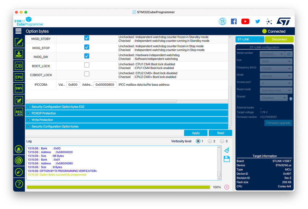

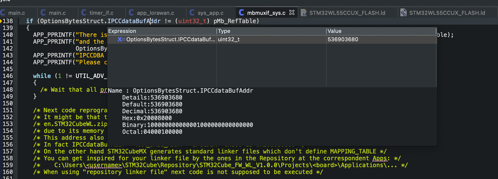

Programmed OB IPCCDBA to 0x800Value of OB struct.ipcc data buffer:
Details:536903680
Default:536903680
Decimal:536903680
Hex:0x20008000
Binary:100000000000001000000000000000
Octal:04000100000

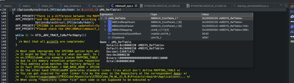

Value of pMb_RefTable:
Details:0x200000e4 <MBSYS_RefTable>
Default:0x200000e4 <MBSYS_RefTable>
Decimal:536871140
Hex:0x200000e4
Binary:100000000000000000000011100100
Octal:04000000344
Values flashing OB IPCC to 0xe4
Details:536874560
Default:536874560
Decimal:536874560
Hex:0x20000e40
Binary:100000000000000000111001000000
Octal:04000007100
Decimal:536871140
Hex:0x200000e4
Octal:04000000344
How do I correct this shift? I've tried many ways and it still doesn't work.

can you please describe your Setup e.g HW(Board and WL chip) /FW/IDE
it seems that the MBSYS_RefTable is not placed properly. It must be at 0x20008000.
If you have generated your project from scratch from cubeMx, the scatter file (.ld) may not be the correct one.
Can you check your .ld file and compare it with
Also please check the M0+ side,
For you information, Cube1.1.0 will be available within few days and will have some improvement regarding the OB loading (done in the FW automatically)

2021-07-27 9:32 AM
Solved
CM4 linker didn't have ref to shared region

In “Subghz examples�? the CM4 linker file places MbMux_ComTable at 0x20008000
CM0PLUS retrieves the MbMux_ComTable address (placed by CM4) as follow:
OptionsBytesStruct.IPCCdataBufAddr = SRAM1_BASE + IPCCDBA <<4;
By default on STM32WL devices the option byte IPCCDBA is 0x800
So OptionsBytesStruct.IPCCdataBufAddr = 0x20008000 matches the Cm4 linker file
What’s happen if the linker file places the MbMux_ComTable somewhere else?
During initialisation CM4 reads the IPCCDBA value and compare it with the MbMux_ComTable address from linker file. If the values are not compatible, CM4 overwrites the IPCCDBA option byte and it reboots the board. On next run value will be matching, and CM0PLUS will retrieve the new address.
When generating code with CubeMX starting from scratch, it will use the CMSIS scatter files (linker file) instead of the one provided by Intopack applications
CMSIS default scatter (linker) file does not define MAPPING_TABLE, the MAPPING TABLE will be placed somewhere in SRAM1.
This means there will be a mismatch between IPCCDBA and MbMux_ComTable, the program overwrites the IPCCDBA Option Byte with "SRAM1" value.
Intopack applications instead provides the MAPPING_TABLE in SRAM2 which has retention properties and can work also in LowPower StandBy mode. So it is strongly suggest to use scatter (linker) file from Intopack applications.
In version v1.0.0 code there was a protection to avoid CM4 to overwrites the IPCCDBA option byte.
The user had to modify manually the CM4/mbmuxif_sys.c in order to allow overwriting the IPCCDBA.
In the v1.1.0 the protection is removed, only a warning is displayed via the terminal logs.
If user does not pay attention IPCCDBA will be overwritten and MAPPING_TABLE placed somewhere in SRAM1 (no retention property) which is a problem for LowPower StandBy mode.
