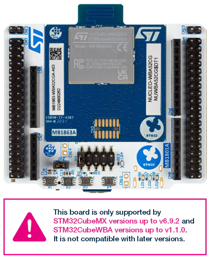

Why there is no NUCLEO-WBA52CG projects in STM32CubeWBA?
What caution should be taken when using STM32WBA52 in STM32CubeWBA?

Hello @Gwo
The NUCLEO-WBA52CG is not supported on the STM32CubeMX V6.9.2 and the STM32CubeWBA V1.1.0 and all newer versions too since the NUCLEO-WBA52CG is not recommended for new designs and we recommend you the NUCLEO-WBA55CG as replacement:
Best Regards.
STTwo-32

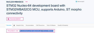

2025-06-05 6:34 AM - edited 2025-06-05 6:35 AM
Also on the Product Page:
https://www.st.com/en/evaluation-tools/nucleo-wba52cg.html
@Gwo What versions were you trying to use?
