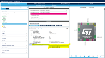

I open a ble_beacon project in STM32Cube_FW_WBA_V1.2.0 which adapted for NUCLEO-WBA55CG。
The default SYSCLK and HCLK1 is 16MHz, when i changed the System Clock Mux to PLLCLK, Then SYSCLK is up to 64MHz,the STM32CubeMX noticed me that the System Clock must be <= 16MHz。
Why the STM32CubeMX noticed this error?
Thanks
2024-01-08 1:04 AM

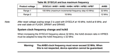

Hell again @Xiaojie
The maximum SYSCLK is 100MHz for voltage scaling range 1 and 16Mhz for voltage scaling range 2:
So, to be able to have a SYSCLK up to 100MHz, you need to change the voltage scaling range from 2 to 1:
Best Regards.
STTwo-32
