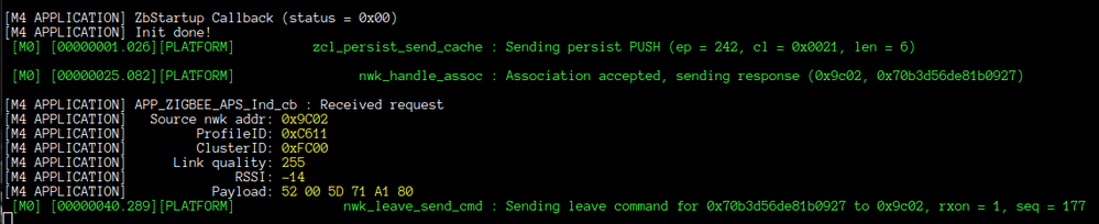

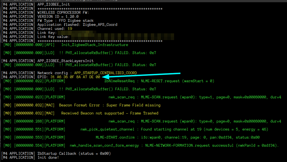

I compile and flash the code and I can see this in the terminal:
Which confirms the use of my Extended PAN ID.
Then, after some seconds, my router seems to be connecting perfectly fine but it is kicked out after 15 seconds. Then it connects again only to be kicked out again and so on.
What is going on? What am I missing?

Once I configured the correct cluster and profile I was able to see the packet my router was sending upon connection. So the encryption key and network joining in general are working well, my only problem is that the coordinator is still kicking out the router after 15 seconds and I have no idea why.

I have attached the Wireshark capture. It includes two instances of my nonSTM32 router device joining, being accepted, sending data to the STM32 APS Coordinator, and finally being kicked out of the network.
Thanks again for the support. I appreciate it!

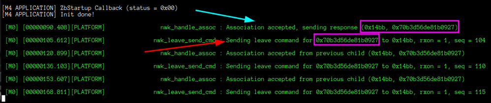

After sending the first capture, I let it run to see what happens. I observed that after several join-leave "cycles", in this case, 6, the STM32 APS Coordinator fails and my nonSTM router can't connect anymore. I know is the STM32 APS Coordinator the one that is failing because my nonSTM router device can connect just fine again after I reboot the STM32 APS Coordinator.
In the attached capture, you can see that something is wrong from captures 253 to 282. My nonSTM router device was not able to connect after capture 253 and it was able to connect again after capture 282 that is when I rebooted the STM32 APS Coordinator.
