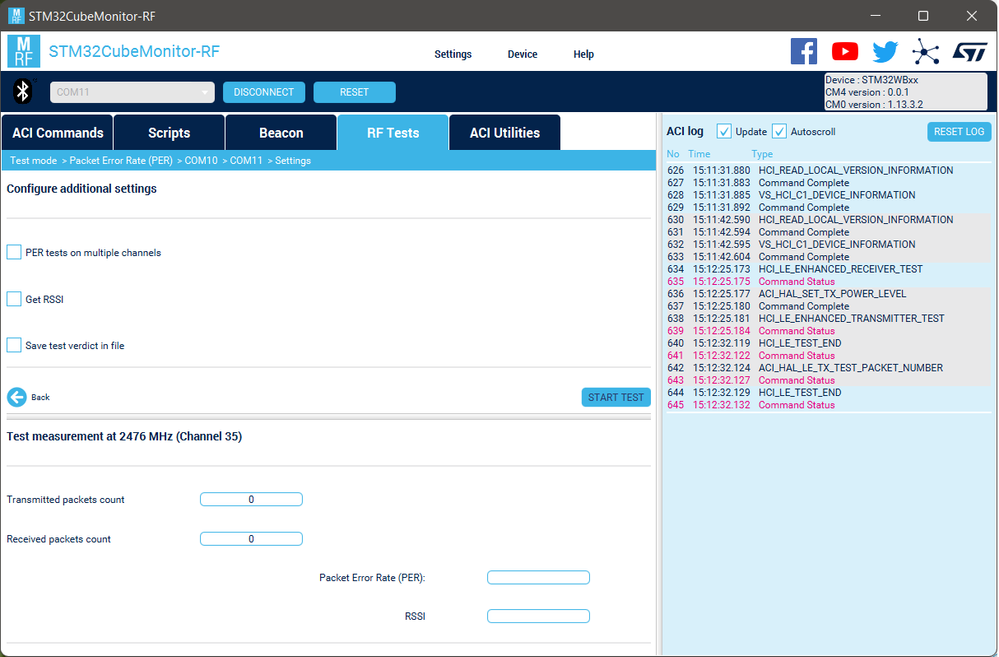

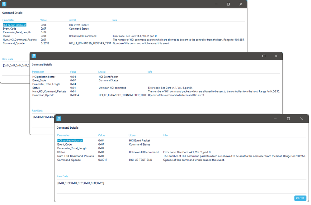

When I tested the same code on a P-NUCLEO-WB55 board (in place of our custom board), it behaves differently, so I'm investigating whether my problem is a result of packet loss. To that end, I am trying to run STM32CubeMonitor-RF's BLE PER test. Unfortunately, I'm unable to execute the test successfully. I'm using STM32CubeMonitor-RF V2.8.1 on Windows 11. I'm trying obtain baseline measurements between two P-NUCLEO-WB55 boards. They are running BLE_TransparentMode_reference.hex from STM32Cube_FW_WB_V1.13.3 and Wireless FW 1.13.3 (BLE Full). The tests fail to run and the log indicates "Unknown HCI Command". I attached screen captures from the test program. I suspect a mismatch between the test program and the BLE_TransparentMode code. Any ideas?

In BLE Full stack v1.13.3, the following commands aren't supported:
In the next package v1.14.0 available soon, these commands will be added in BLE Full stack. In order to see which command is supported on which BLE stack, you can look this document. A wiki page about wireless stack information is under construction also.
