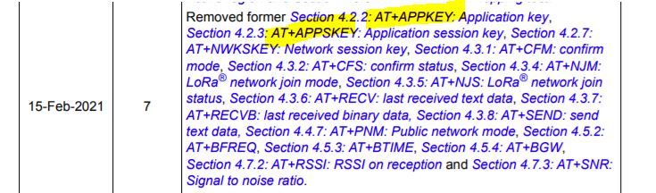

As per the application note AN4967 Rev 7 AT+APPKEY command has been removed from the firmware of AT_SLAVE. I would like to know how can i set or enquire the APPKEY via AT Commands. Also is there possibility to set this key in firmware itself?
Since as per the lora standard for OTAA activation, user should setup APPEUI, DEVEUI and APPKEY. But since command for AppKey removed so i wonder how can i set this key on module.
Please update and share if there is any good reason to remove or the way to set the key in firmware itself.

Effectively this AT_SLAVE command has been removed by mistake from this I-CUBE-LRWAN version, and our team is currently working to fix this and reintroduced this command in the next release.
So, please keep an eye out for the coming update.
For the time being and to overcome the problem, you have to modify the commissioning of your device by the way of the “se-identity.h�?.

2021-10-13 11:27 PM
Any news concerning this issue ? Is there a new release already ?
EDIT : I see now in the document's revision a new revision that updated AT Commands. (5.10.2021) . Thanks for the patch, will try it
