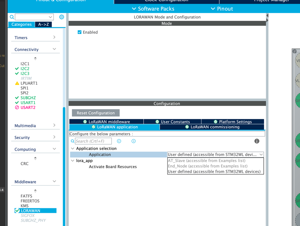

I'm trying to get started using the STM32WLE5-series chip, and I'm really struggling to figure out how to get the `AT` firmware example going. I see it in the SDK package, but it's only for the STM32WL5-series (dual-core) chips. I see this setting in the .ioc file, but it doesn't tell me how to get to the Examples List?

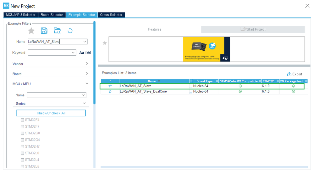

  • You can import LoRaWAN_AT_Slave example in your project if you are working with Single Core product( not possible with Dual Core product). The LoRaWAN_AT_Slave available example is created based on STM32WL55JCIx MCU and can be selected through STM32CubeMX > Example Selector:

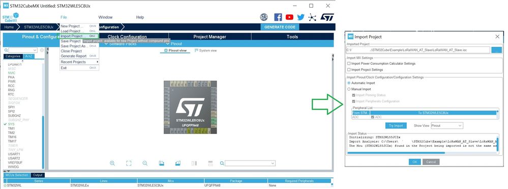

0693W00000ANbNmQAL.png After opening the selected project and saving it, you can start a new project using STM32WLE5C8 and use the Import Project feature:
0693W00000ANbReQAL.jpg The Import Project menu eases the porting of a previously-saved configuration to another MCU. For further details about the different CubeMX features, you can refer to STM32CubeMX User manual.
