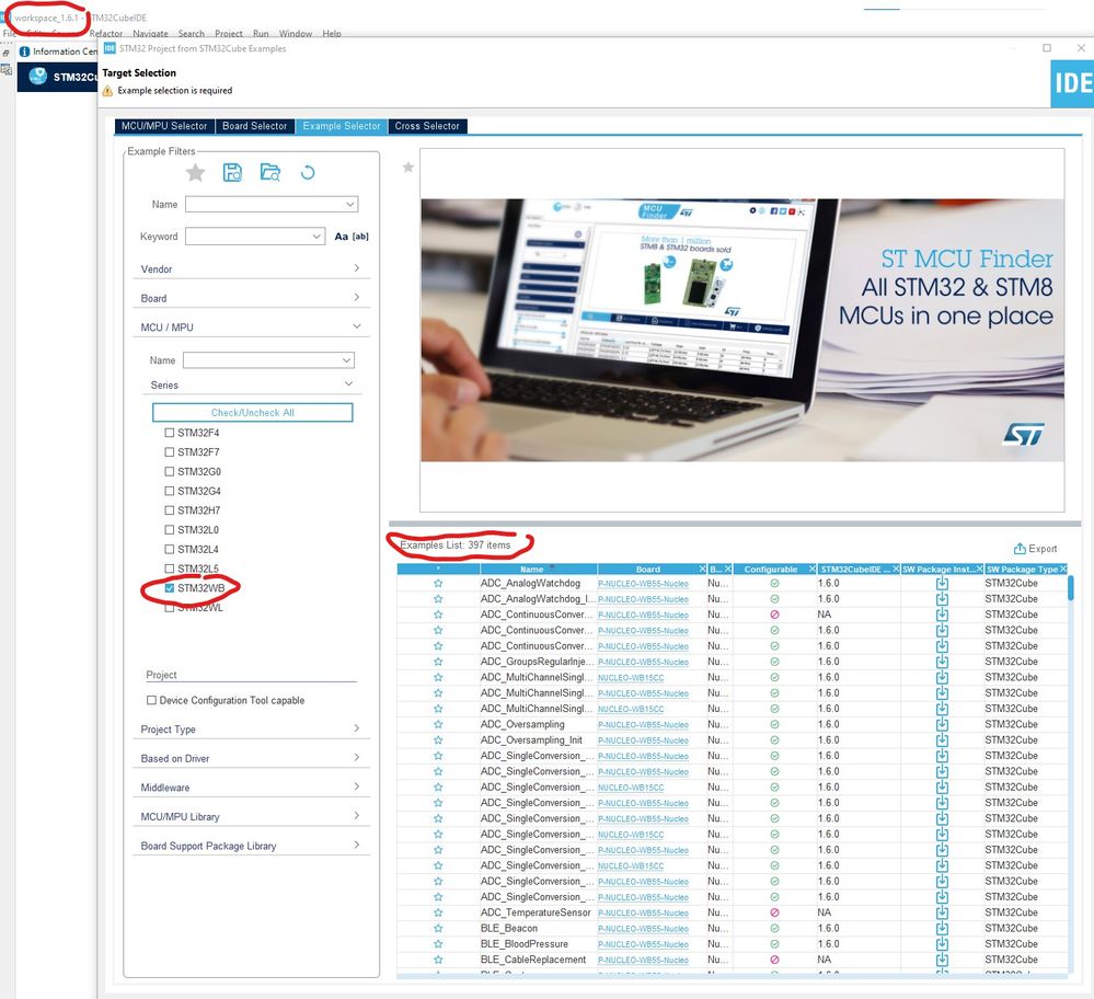

I'm using the STM32CubeIDE (Version: 1.6.1) and I've installed the package for the family STM32WB (rel 1.11.1) but into the section 'Example Selector' I don't find any example for this board. I don't understand what's the issue. What I should do for import some example to start to work correctly with this board?

I've this example:
but I need example for the board STM32WB5MM :
For this board I find no example. Could you help me for understanding where is the problem?

You're right sounds no example as part of example selector if WB5MM.
Looking at the pack/ STM32Cube_FW_WB_V1.11.1\Projects\STM32WB5MM-DK sounds some examples but all of those are IAR only supported :sad_but_relieved_face: at that time ...
Let's hope CubeIDE ones are coming if next release.
