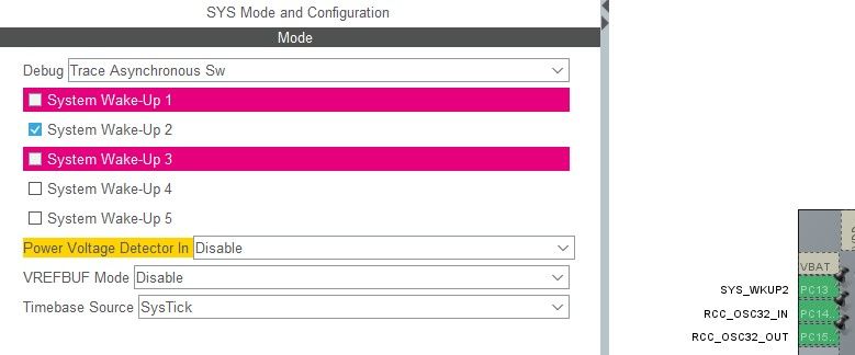

Here's my *.ioc file showing that I have wakeup pin 2 (PC13) setup for my interrupt:

2021-05-19 3:01 PM
Maybe your signal source is open-drain and needs a pull-up? Internal ones can be enabled in PWR_PUCRC.
Also PC13 can be "taken over" by RTC. Check for that.
2021-05-20 7:26 AM
Thanks for the direction! I tried tying +3.3V to the signal line (in case that was the issue) and that didn't resolve it, unfortunately. I did find that option for RTC to take over but, at present, I don't have an RTC running (not sure if that needs to be running, I'm not using it as I'm not trying to wake it with the RTC, I'm trying to wake it with the wake pin (PC13).
To try and reduce the number of variables, I started a new project and I eventually got it working (potentially) but I had to set the pin to be an interrupt (GPIO_EXTI13) rather than a wakeup pin (SYS_WAKEUP_2) in the *.ioc file. I don't have my multimeter with me right now so I can't verify it's going into STOP2 mode (though it appears to be going into some kind of sleep mode) but I'm a bit confused that it should even work as an interrupt rather than a wake pin.
The datasheet says the following about waking with GPIO pins in STOP2 mode (pg 38 of the datasheet):
I/Os with wakeup from Standby/Shutdown capability: PA0, PC13, PC12, PA2, PC5Bah, I'm an idiot, it WILL work with interrupts in Stop2 mode, I was originally looking at the wakeup as I was considering using Shutdown mode at one point. I'll have to take another look at that in case I do want to get it to work in shutdown mode down the road (I think it might create more problems than it's worth though as it force me to reinitialize a number of variables that I need, so it'll be a pretty slow startup.
