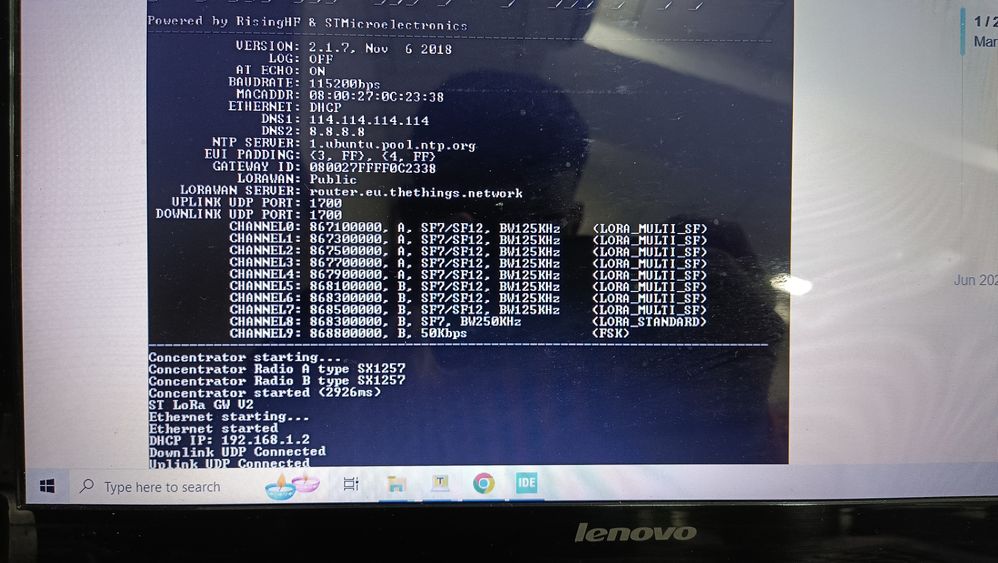

When we set gateway according to the region and display it using terminal(Tera Term) we can we for India terminal show FSK : OFF.IMG_20231101_165015.jpg
And if we set gateway to European region then gateway show FSK : 50 kbps. ( terminal photo for europe )

On this basis I'm able to say that europe support FSK and not India.
Is this your own gateway?
As I had told that sx127X is support FSK and most gateway have this feature also my region but the FSK Modulation is not LoraWan so this feature was disabled usually.
But if it's your own and you can config your gateway so you can enable this feature.

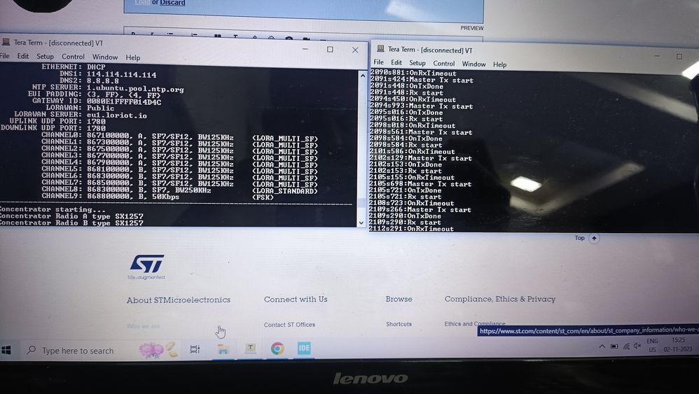

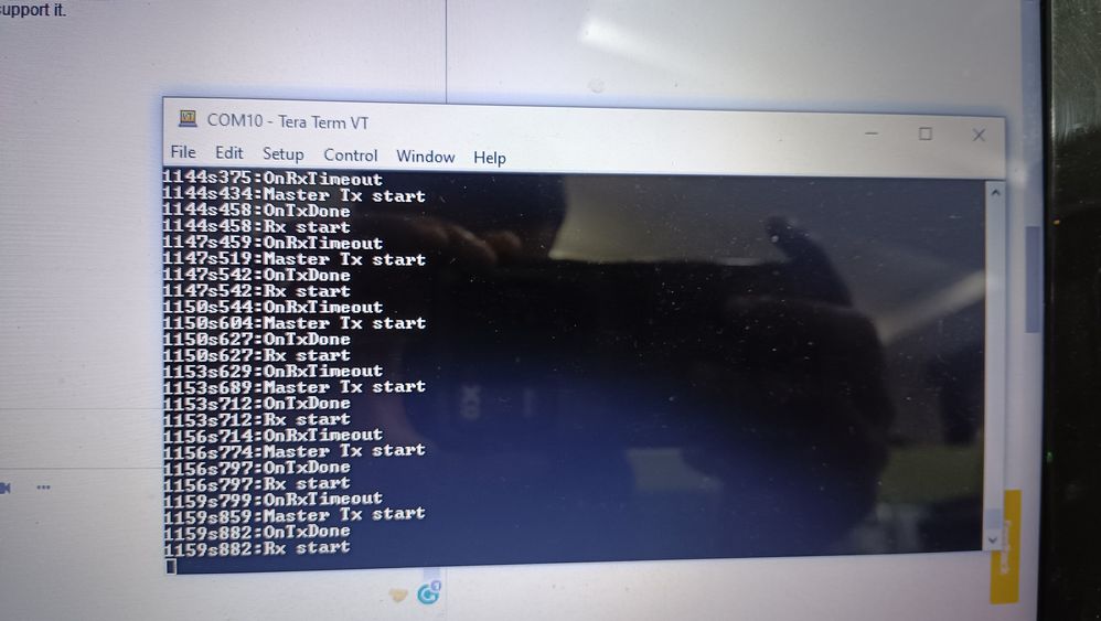

But the node and gateway are not getting connectedIMG_20231102_110612 (1).jpg.
Can you help me with more information to connect gateway and node

As gateway terminal image shows FSK at channel 9 and 868 frequency.
As I downloaded the library code the default set region is Europe and frequency is 868.
And I have made these changes #define USE_MODEM_LORA 1
#define USE_MODEM_FSK 0
to
#define USE_MODEM_LORA 0
#define USE_MODEM_FSK 1
However, the gateway and node are not getting connected.
Thank you.
you have to config Bandwidth Baud rate and Channel to match with your gateway too.
