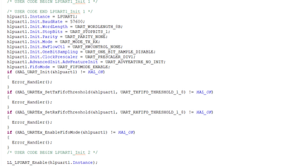

hi @Karl Yamashita ,
Thanks for the reply, here attached the lpuart config and callback

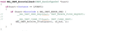

Meanwhile I also tried to debug more to fix this issue and found that after 11th byte it continuously receive Overrun error and because of that Rx interrupt not working. To fix this issue I have added following callback .
After adding the error callback, disable Rx interrupt issue was fixed but I received the data loss on uart.
Can you please guide me a right way to fix this overrun error and data loss issue?

Attached the source files here for reference.
As per section 2.15 of the ES0394 I tried to Increase the LPUART kernel clock frequency, still facing an same issue on 57600 baudrate. I already tested with lower baudrate configured as 9600 and everything working.

When posting code fragments please use the code formatting tool </> rather than paste in bit maps. Thanks.
