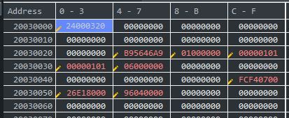

} while(pIpccdba->pDeviceInfoTable->TableState != 0xA94656B9);ipccdbaOffset = 0 => shared table reference start @ 0x20030000 => OK
i get valid data for the referenced Device-Info-Table @ 0x20030024, but no reference for the System-Table @ 0X2003000C (offset 3)
see:
If I am correct, the system table is set by the CoPro FW (Stack or FUS )?
