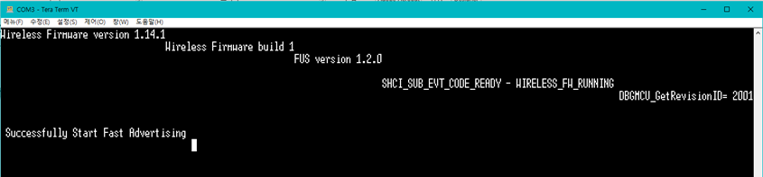

In my experience, the BLE doesn't start when debug mod. if you just implant code and check internal massage using USART terminal then you can see a massege like these.
