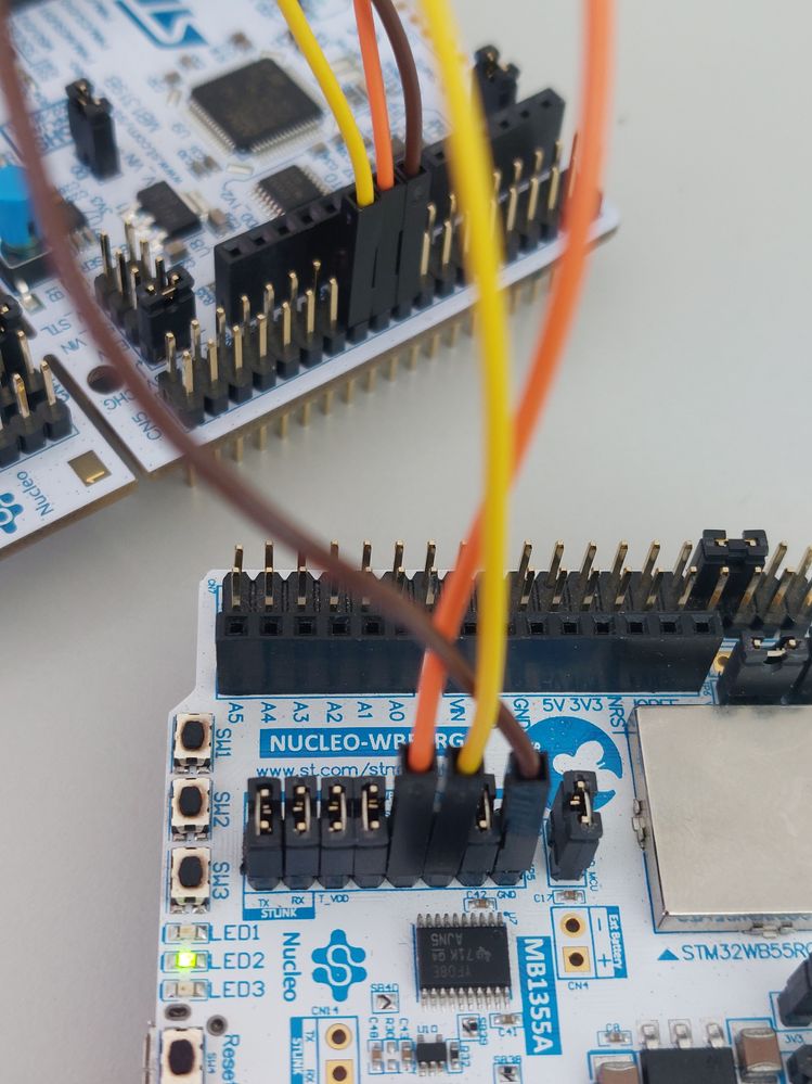

Just tested, it is working fine with STM32CubeProgrammer. I connected an MB1355 to an MB1319 (STM32L452) with 3 wires only.
MB1319 ST-LINK is kept under reset to allow using MB1355 one.

No, as you wrote, CN13 is a "reserved" connector, so please avoid touching it.
Use JP5 and remove appropriate jumpers to get the SWDIO/SWDCLK/GND signals and plug them to another target. Should work.

@Mike_ST I see that you put a jumper between VDD and BOOT0. Did you put a jumper somewhere else on the MB1355 ?

This BOOT0 jumper is not important as the ST-LINK probe on the MB1355 is disconnected from the STM32WB55.
I haven't done anything else.
