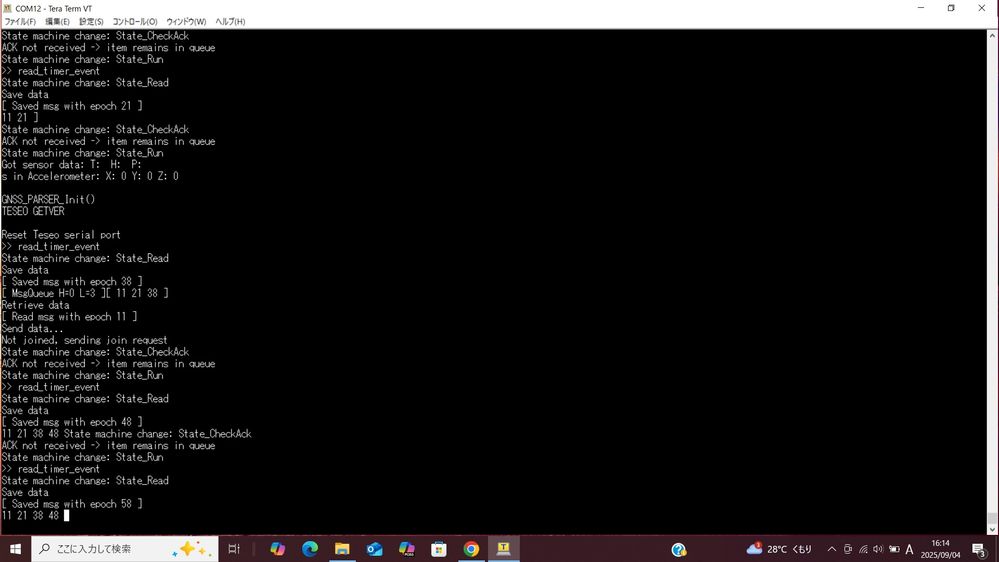

2025-09-04 12:23 AM - last edited on 2025-09-04 12:49 AM by Andrew Neil
I deleted some of sensor related codes. Teraterm showed following message. What does it mean? I think there are still errors remaining.
2025-09-04 12:54 AM
It would be easier to read posting as text rather than a screenshot.
(To post formatted text, see this)
@martian_first wrote:Teraterm showed following message. What does it mean?
Again, search the source code for those messages to see what causes them to be emitted.
"Not joined" sounds like issues with joining the LoRaWAN network ?
