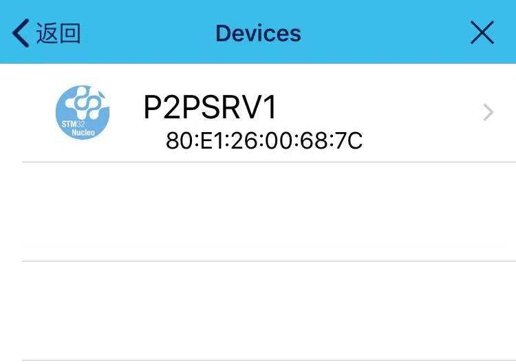

First, I use ST BLE sensor, succeed.

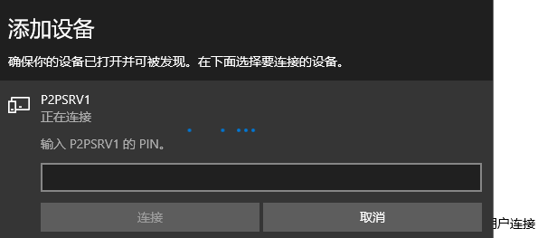

second,use conputer to connect,I need to write PIN.

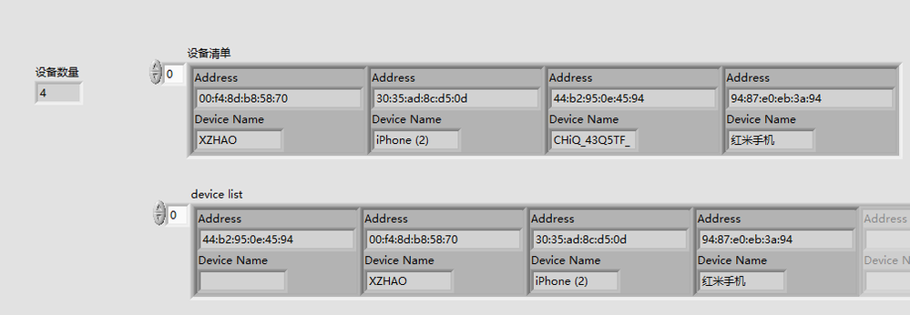

Last,I use labview to scan ,I cannot find it.
I want to set up a route from stm32WB to my PC base application .

Pin is set in aci_gap_set_authentication_requirement(). It is "111111" by default
2019-11-25 6:18 AM
thanks,I have find it :BleApplicationContext.BleApplicationContext_legacy.bleSecurityParam.Fixed_Pin = 111111;

but I still connot connect succeed. my computer can connect iphone(2) which connect to STM32WB board succeed.
