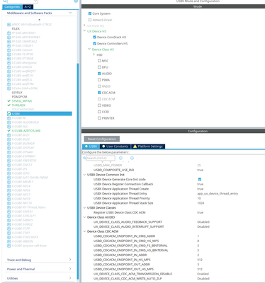

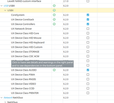

On CubeMX v6.14.1 and X-CUBE-AZRTOS-WB v6.2.0, I am not able to add a USB record/playback device.
This means that I cannot generate USB Device descriptors using CubeMX.
Why is this not possible yet? What are the alternatives?

We only deliver BLE Audio sample applications on bare-metal. If you are looking for a ThreadX sample application that uses USBX, you can use the Ux_Device_CDC_ACM app for NUCLEO-WBA65RI in the STM32CubeWBA firmware release. You can also find a FreeRTOS BLE example for NUCLEO-WBA55CG on GitHub Hotspot if you prefer another OS: https://github.com/stm32-hotspot/STM32WBA-BLE-HeartRate-FreeRTOS.

Hi @NRedd.2
Working on STM32WBA6, you should not point on X CUBE WB. Internal ticket is submitted to dedicated team (210018)
Given that there haven't been any significant updates associated with the X-CUBE package, or directly impacting the functionality, it's unlikely that an upgrade will occur unless a major issue arises. Did you track any related issues?
You can manually select the Azure RTOS version without using CubeMX, as each X-CUBE package is associated with a specific Azure version by dev team.

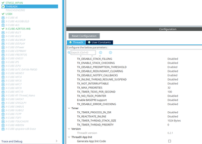

2025-05-19 3:04 AM
Hi @FBL,
Thank you for your response!
Is it not possible to add ThreadX using CubeMX anymore for STM32WBA6?
Even when I select manually, I do not see a recording or playback option.
An option to select ThreadX is grayed out. What is your suggestion regrading manually selecting AzureRTOS version? It is not clear to me.
May I ask why I cannot use X-CUBE-AZRTOS-WB here? Can you guide me on the workflow for WBA6 please?
