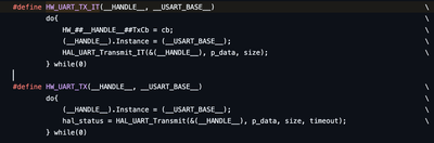

Going through it, I saw that in the end we point to this:
That sends the data using the Blocking or IT APIs. I tried using them, but did not work either way.
Could you point me to something more specific, please?
