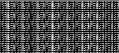

2023-09-04 1:25 AM
data on serial monitor
tera term setting
what is the reason of data mis matching ?
2023-09-04 2:10 AM
Check the TeraTerm Setup / Terminal settings "Coding (receive / transmit)".
And do you have any proof that sprintf is working correctly?
Try sending some pure ASCII string directly with HAL_UART_Transmit.

2023-09-04 2:40 AM
Hello
You have different paritysettings. Put parity none to code or parity odd to your terminal settings.
Br J.T
2023-09-04 2:54 AM
Currently outputting in the equivalent to 7O1 mode, disable parity on the STM32 (NONE) so it is using 8N1 mode

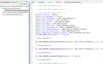

2023-09-04 3:12 AM - edited 2023-09-04 3:13 AM
putt the parity non now the result is
putt the parity none,now the result is
2023-09-04 3:49 AM - edited 2023-09-04 3:50 AM
What about baudrate in terminal, now its 115k2 in mcu
