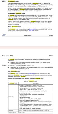

According to the reference manual, you can use the shutdown mode.
Then, the best solution will be to write your code to connect to the gateway and send his package directly after the wake-up and then hi can get back to the shutdown mode.
