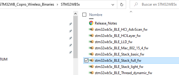

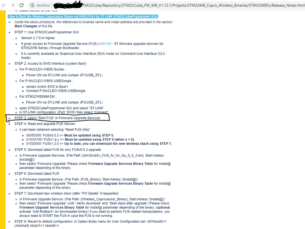

Refer to /Projects/STM32_Copro_Wireless_Binaries/ReleaseNote.html for the detailed procedure to change the Wireless Coprocessor binary.I found the binaries already
But as i try to follow the release note instructions i get stuck in STEP3
There is no "Start FUS" button anywhere, am i doing the raindance wrong?
Also if i try to "firmware upgrade" anyway is asking me for the start flash addr, thats not in any STEP

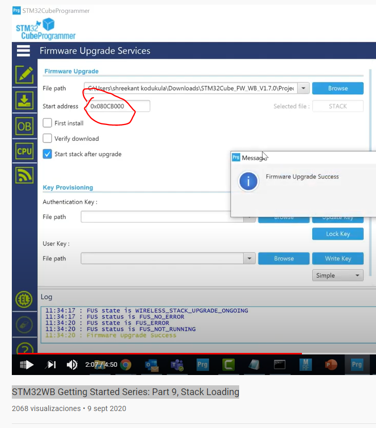

okay i found this video
STM32WB Getting Started Series: Part 9, Stack Loading
https://www.youtube.com/watch?v=wheGvdXsi4o
Im going to try and use the addr 0x080CB000 seen in the video

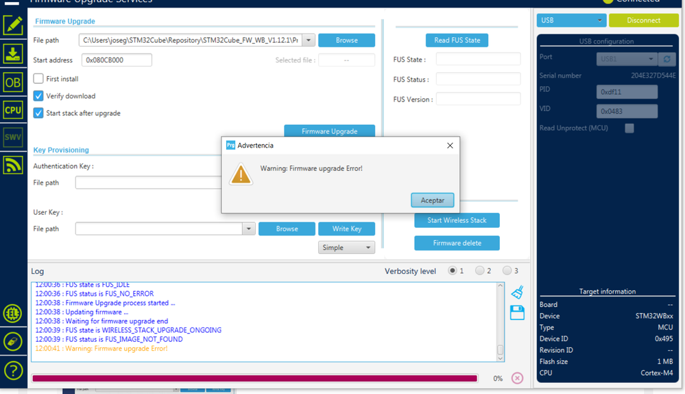

meeeeeeeeeec, warning, but it worked? logs:

12:06:34 : Firmware Upgrade process started ...
12:06:34 : Updating firmware ...
12:06:34 : Waiting for firmware upgrade end
12:06:35 : FUS state is WIRELESS_STACK_UPGRADE_ONGOING
12:06:35 : FUS status is FUS_IMAGE_NOT_FOUND
12:06:37 : Warning: Firmware upgrade Error!
