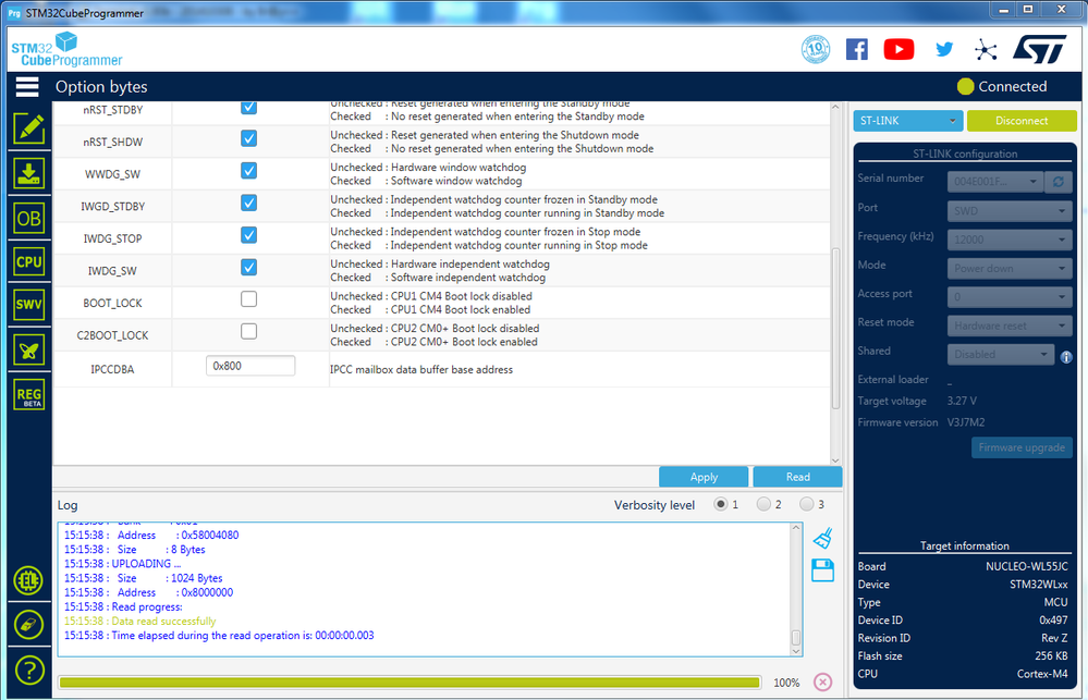

The option byte IPCCDBA probably does not match MAPPING_TABLE address in the linker file at STM32CubeIDE\CM4\STM32WL55JCIX_FLASH.ld.
following rule shall apply IPCCDBA = (MAPPING_TABLE>>4)
please try to program manually option byte IPCCDBA to 0x800. The board will restart to reload the new OB value.
This will be automatically done by the FW in next release,
2021-03-11 6:29 AM
Even after modifying manually the IPCCDBA in stm32cubeprogrammer, I have the same issue in cubeide.
