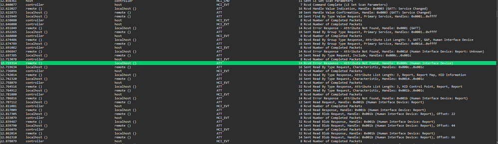

2024-12-14 5:07 AM
This is the packet captured on Wireshark.
I hope it do help.
