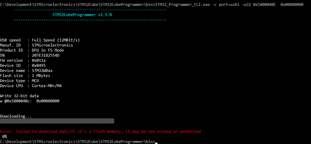

As FUS version is V1.1.0, the revertion to the manufactory state can be achieved writing 0x00080000 at address 0x5800040C.
2020-09-02 5:44 AM
This is a PWR_CR4 ?
And write result is Error
Mey be need to write 0x00008000 (set C2BOOT) ? not 0x00080000.

2020-09-03 6:55 AM
Indeed!!! the value must be 0x00008000.
