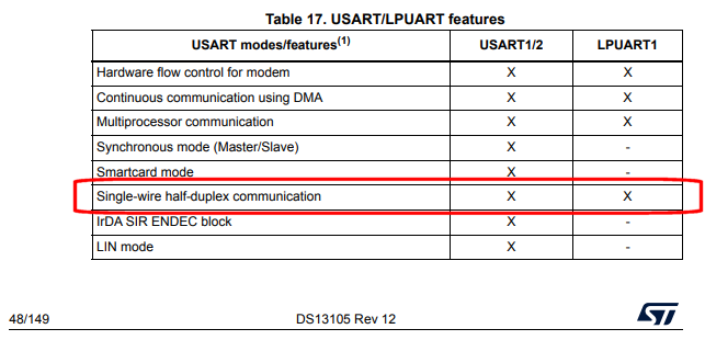

2024-04-29 5:55 AM - edited 2024-04-29 5:55 AM
According to the datasheet, they both support single-wire half-duplex:
@DavidG7 - Maybe if you do that, one could use each pin ... ?
:thinking_face:
2024-04-29 6:15 AM
On the one wire (Half-duplex) mode, both need to enable the TX pin. this pin is the same for both of them (PA2).
Best regards.
STTwo-32
