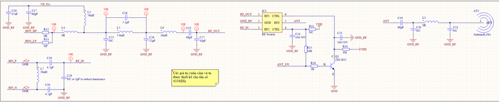

I created Lora project which send and receive data. I designed my board, no TCXO.
My schematic:

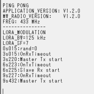

My result:
the random value is 0, TxTimeout everytime.

I have the other board the random value is not 0 but the LoRa Tx status is always TxTimeout.

I follow the Ping Pong example project. I soldered the R12 resistor to choose LP LoRa communication, my project work correctly but I soldered the R13 resistor to choose HP LoRa communication, the LoRa Tx status is always TxTimeout
Please support me.
