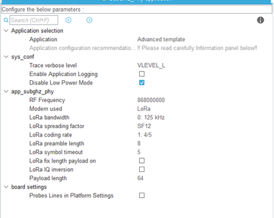

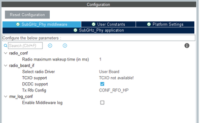

I tried the same with my STM32WL55-Nucleo. I configured the RF switch pins for HP usage
and the SubGHz middleware with the LoRa settings
Then I use the following code to transmit a test message after the initialization of the SubGHz middleware
