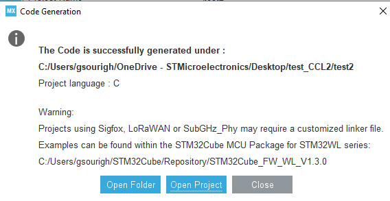

I used the CubeMX 6.8.0 and the STM32WLE5 MCU : I activated the "USART1", "SUBGHZ "and "SUBGHZ_PHY": this is what I got after generate the code

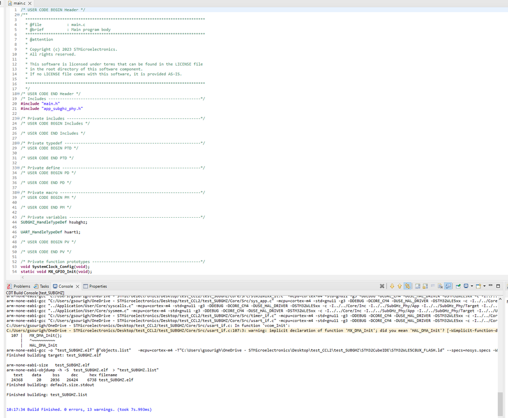

After building the generated code
