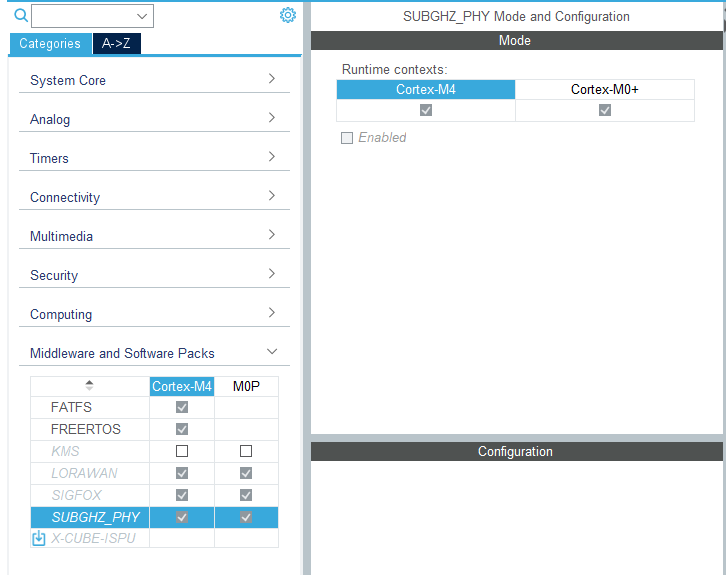

First of all, I want to set SUBGHZ_PHY, but the Enable check box is disabled as follows.
And files related to SUBGHZ_PHY and Radio are not visible after [Generate Code].
Could you let me know why it is disabled and how I can use it?

2023-04-11 2:01 AM - edited 2023-11-20 8:35 AM
Hello ,
For the SUBGHZ_PHY in Middleware and Software :
For dual core you need to Activate the IPCC and the SUBGHZ.
Foued

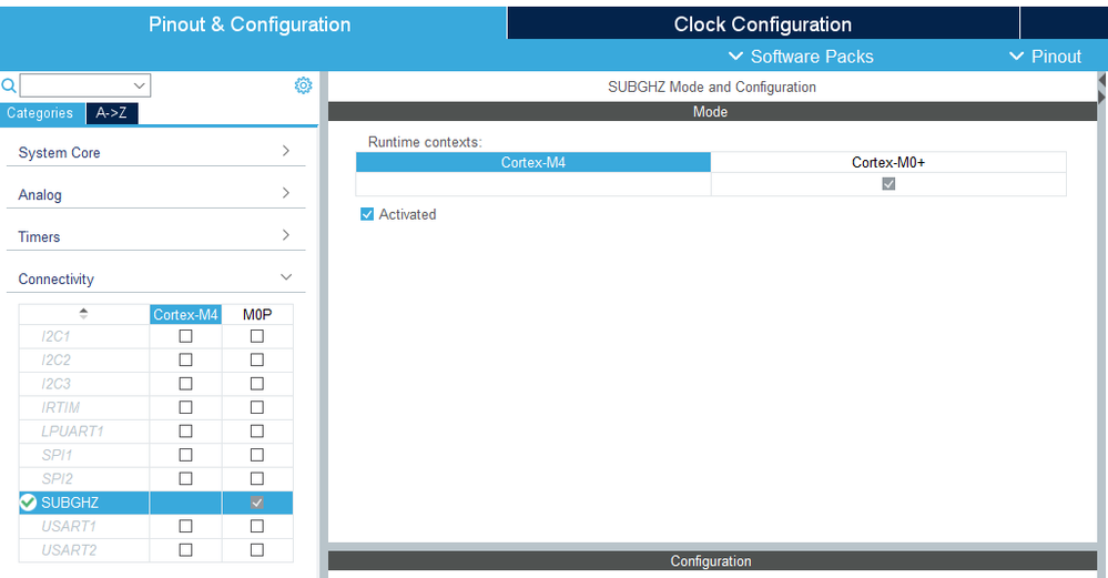

2023-04-11 1:42 AM - edited 2023-11-20 8:34 AM
Hello @SOn, Dong-Seong ,
Make sure that you are using the latest version of STM32CubeMX 6.8.0 .
If I select the SUBGHZ peripheral under the Connectivity category, I can check the box next to Activated.
Foued
2023-04-11 1:56 AM - edited 2023-11-20 8:35 AM
Hi.
It is SUBGHZ_PHY in Middleware and Software, not in Connectivity.
I want to enable SUBGHZ_PHY in Middleware and Software
Hello ,
Foued
2023-04-11 2:07 AM - edited 2023-11-20 8:35 AM
hi @SOn, Dong-Seong ,
to use the SUBGHZ_PHY driver, you need first to enable the SUBGHZ peripheral.
you also need to enable RTC to configure timer server.
2023-04-11 3:41 AM

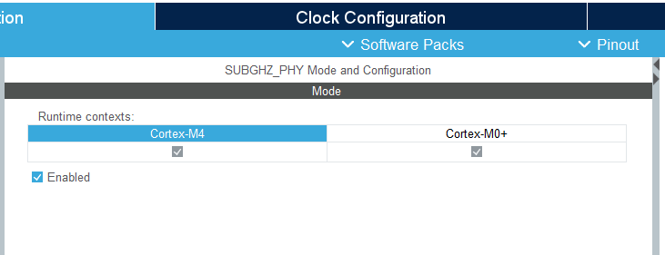

Oh
When I activated IPCC, I was able to enable SUBGHZ_PHY.
I resolved it
Thank you so much
