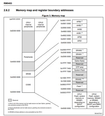

I am looking for a memory map for the stm32wl5moc. I thought I found one before but cannot find it again. It is not in the datasheet. Any suggestions? Thank you.

From RM0453:

From RM0453:

Thanks; a coworker pointed me to that reference manual, versus the programmer's manual or datasheet.
