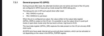

As Said @TDK , this information should be available on the RM0511 specially on the paragraph 7.3.1:
During and just after reset, the alternate functions are not active and most of the 1/0 ports are configured in GPIO input pull-up mode except the SWD debug pins.
The debug pins are in AFO pull-up/pull-down after reset:
Best Regards.

Look at the default GPIO register settings in the Reference Manual.
