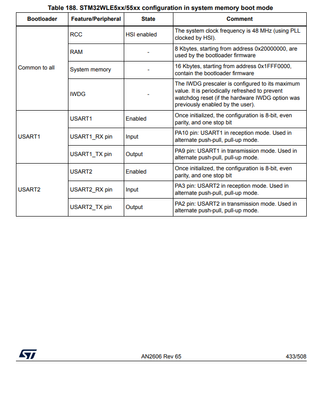

Hello @SBaro.11
For the STM32WLE, the system bootloader via USART need to use PA10, PA9 for USART1 and PA2, PA3 for USART2:
For PB6, PB7, you need to use the open bootloader.
Best Regards.
