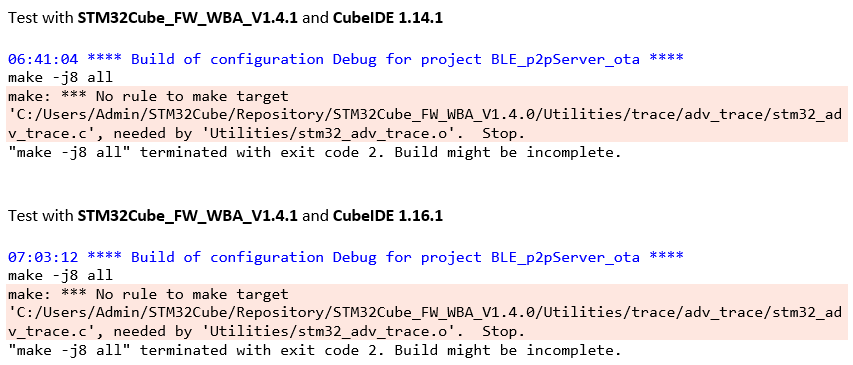

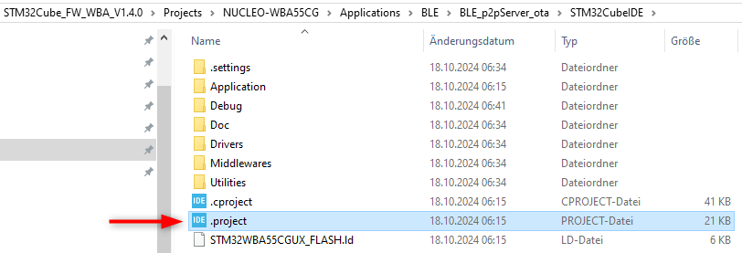

I startet the project directly from the regarding project file in the FW-Package:
But i got these error messages:

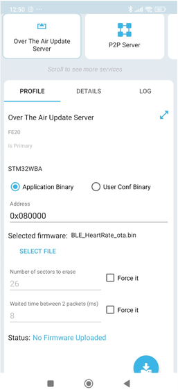

Then I opened the ST BLE Toolbox on my Android phone and established a connection to the board. So far everything is OK. Then I started the OTA update with the file BLE_HeartRate_ota.bin.
The upload starts and I get the message upload complete. Unfortunately nothing has changed. BLE_p2pServer_ota is still active.
