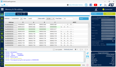

Hi, @AScha.3
I've figured out where is the problem.
I didn't connect the VCC pin in the STLINK-V3 to my Target +3V3 Rail.
So the Target Voltage always shows Zero.
When I connected the VCC pin to my Target +3V3 Rail now everything came back to normal.
Thanks.
