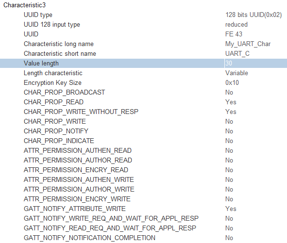

In cubeMX i have set the length of the value to 30 and the length of the "Value length" to Variable because i also want to send less than 30 characters.
Then I checked the variable "SizeUart_C" in the file p2p_server_app.c , which has the value 30.
