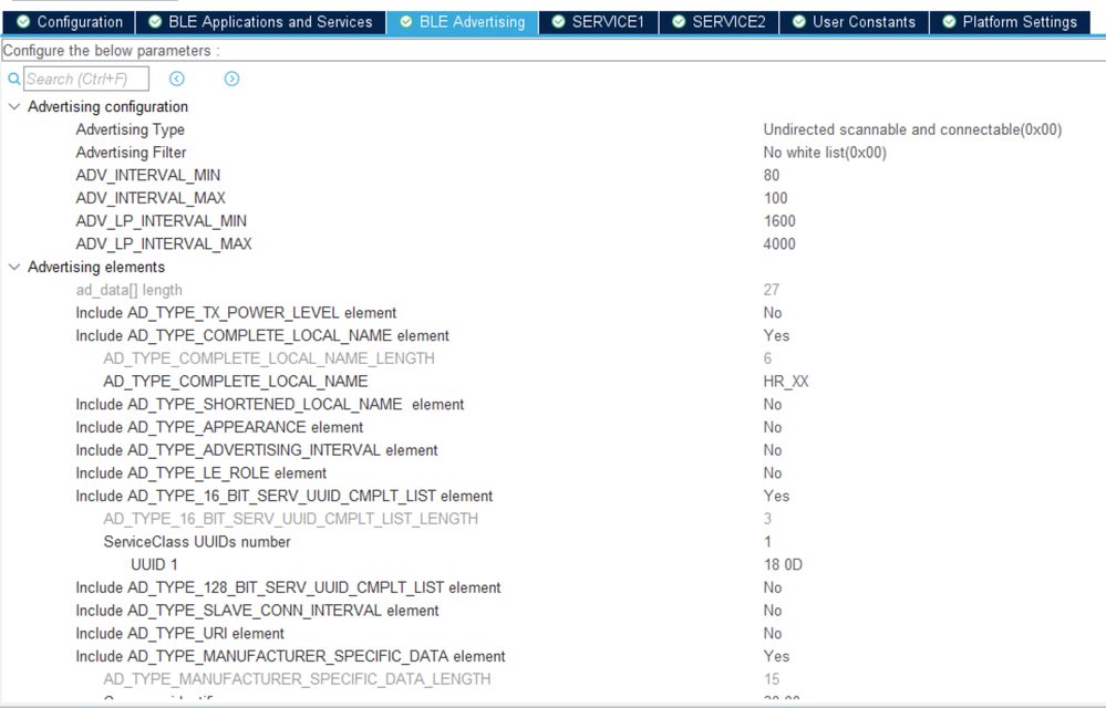

I created a custom service with two services and successfully debugged the code... But the board isn't advertising.
I am not able to see the advertised name in the ST BLE Toolbox app.
i am attaching a screenshot of the Cubemx advertising tab
Can you please help me with this
Thanks in advance!

Hello @Pallavi
Does it advertise when using another FW (an example from the CubeWB for example)?
I think you didn't start the Wireless stack. So, there is not advertisement. So, please try to update your stack and firmware. After that, click on the button "Start Wireless Stack" and upload your Firmware and retry.
