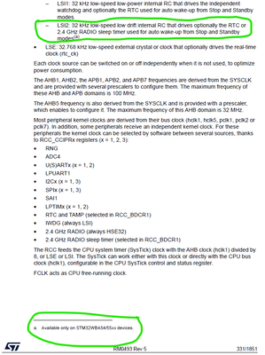

- Further, in reference manual mentioned that LSI2 is available for STM32WBA54/55xx devices,
Means, not available for STM32WBA52xx devices:
- Can you please provide guidance, related to which source require for Radio-Sleep-Timer-Clock,
And how to make BLE working properly, is that further configuration requires?

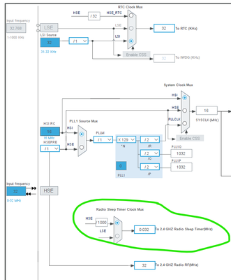

But unfortunately, with HSE/1000 as source, BLE not working properly, in this case, application able to capture BLE advertisement data but not able to connect over BLE, every time connection timeout occurs, scenario is reproduceable,
only upon LSE as radio-sleep-time clock-source working properly,
I have tried multiple times with different boards, applications & mobiles,
tested with Nucleo-WBA52CG, App ST-BLE-Toolbox.
It will be really helpful in case, you will able to provide a working example where HSE/1000 configured for Nucleo-WBA52CG, you can use existing examples, such as p2p_server_ota where LSE clock used and only modify related to HSE/1000 and test.

I confirm there is two valid options to run BLE over STM32WBA52 without LSE.  Both solutions are validated for BLE.
  1. Option #1 : Running using HSE_DIV100
    I do confirm that it is possible to use HSE_DIV1000 for BLE.
PeriphClkInit.RadioSlpTimClockSelection = RCC_RADIOSTCLKSOURCE_HSE_DIV1000;
Of course, using HSE_DIV1000, it is no more possible to mange low_power_mode as HSE must remains always active.
Low power mode must so  be disabled :
#define CFG_LPM_LEVEL (0)
To ease testing of HSE_DIV1000 over CubeFW code example, you may use attached .pdf doc - I tested it on STM32CubeFW code example running over Nucleo-WBA55 board  (tested using BLE_P2P_Server and BLE_HeartRate) code examples.
  • Option #2 :Running using LSI2
Since last CubeFW delivery v1.6, LSI2 usage is now possible.
More details here : https://wiki.st.com/stm32mcu/wiki/Connectivity:STM32WBA_without_LSE_crystal
