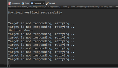

2023-07-31 7:32 PM
After this change, the ST-Link cannot find the board anymore.
I tried one more deivce but still it becomes not accessable.
How can I restore the board?
2024-04-17 4:57 AM
Did you got this error?
