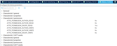

Was this ever solved? I am trying the same thing and getting the same result as SWenn.1.
Following the video "BLE Security with STM32WB - 05 Pairing - just works lab", https://www.youtube.com/watch?v=j-d7SY2BL3I. My settings are as below. When I try to read the characteristic, instead of prompting to pair, it disconnects.
From Teraterm:, I get this...
>>== ACI_GAP_PAIRING_COMPLETE_VSEVT_CODE
- Pairing KO
- Status: 0x1
- Reason: 0x0
>>== HCI_DISCONNECTION_COMPLETE_EVT_CODE
- Connection Handle:   0x803                                                                                                                                                                          - Reason:    0x13
