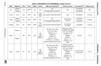

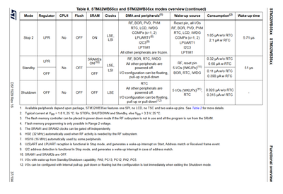

But how low? I can't find how much it consumes in STOP MODE 2.
Is it written somewhere?

in datasheet https://www.st.com/resource/en/datasheet/stm32wb5mmg.pdf it says
in WB55 datasheet https://www.st.com/resource/en/datasheet/stm32wb55ce.pdf on page 36/37 you can find :
