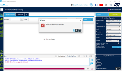

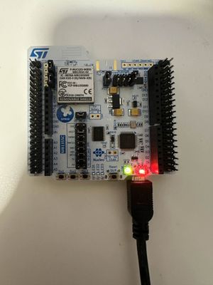

Could you share a picture of you're connections (board to PC and ST-link if it is not an eval board). Also, a screenshot of the error that you are receiving will trying to connect to CubeProgrammer with ST-LINK will be really helpful.

2024-08-05 9:43 PM
It is connected to CN15

Is this manifesting as a J-LINK or an ST-LINK ?
Trying to understand what you're illustrating with the selective Device Manager image.
I'd agree it's not showing an ST-LINK, so drivers, or cabling, or that the STM32F1 with the ST-LINK firmware has been wiped or corrupted.
